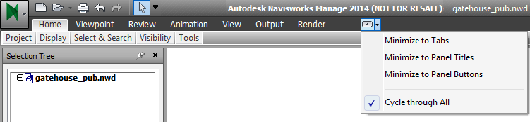

To Toggle the Ribbon Size
To toggle the ribbon size
  1. Click the drop-down arrow in the ribbon tab bar, and select the desired minimize ribbon state.
  2. Double-click the name of the active ribbon tab or anywhere in the ribbon tab bar.
    The ribbon toggles between the selected minimize ribbon state and the full ribbon state.
