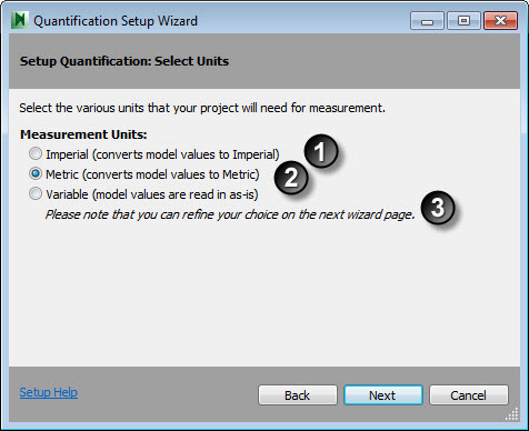

Setup Quantification: Select Units
Setup Wizard - Select Units
Select the unit of measurement you want to use in your project.
1. Imperial: Converts units in the model to imperial units, for example feet, pounds or gallons.
2. Metric: Converts units in the model to metric units, for example meters, kilograms or litres.
3. Variable: Uses existing model values. You can change the unit for each individual takeoff property on the next wizard page.
