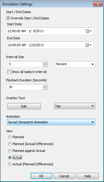

In the
Simulation Settings
dialog box, click the drop-down arrow in the
Animation
field, and select
Saved Viewpoints Animation
Click
OK
