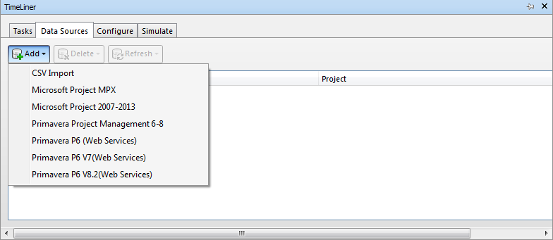

Supported Scheduling Software
Autodesk Navisworks TimeLiner supports a variety of scheduling software.
Note: Some of these may only function if the relevant scheduling software is installed.

Microsoft Project 2007 - 2013
This data source requires Microsoft Project 2007 to Microsoft Project 2013 to be installed.
Primavera Project Management 6 - 8

Microsoft Project MPX
TimeLiner can read Microsoft Project MPX files directly, without needing a copy of Microsoft Project (or any other scheduling software) installed. Primavera SureTrak, Primavera Project Planner and Asta Power Project can all export MPX files.

Primavera P6 (Web Services) V6 - V8.2

Asta Power Project 11 - 12
