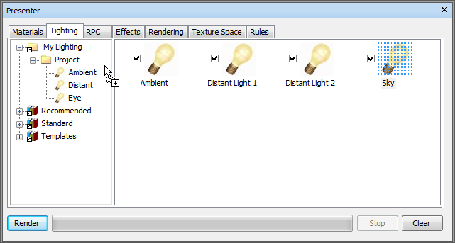

Copy Lighting Effects into a Custom Folder
To copy lighting effects into a custom folder
  1. In the Presenter window, Lighting tab, click a lighting effect in the right pane, and drag it to the desired location under the My Lighting folder in the left pane until a mouse pointer displays a small plus symbol.
  2. Release the left mouse button to drop the lighting effect into the folder.
    Note: You can also copy lighting effects between the folders in the left pane by either dragging and dropping them, or using the Copy and Paste options on the context menu.
