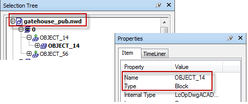

You can configure the Revit file conversion parameters to change the way the file is displayed in the Selection Tree. For example, you can divide the file into levels to organize the model hierarchy by File at the top level, down to Category, Family, Type, and Instance. See To Divide Revit Files into Levels. Also, for Revit files, sub-parts are named according to the material from which they are made. For example, a wall may be broken up into sub-parts composed of asphalt or aluminium.
