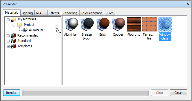

Copy Materials to a Custom Folder
To copy materials into a custom folder
  1. In the Presenter window, Materials tab, click a material in the right pane, and drag it to the desired location under the My Materials folder in the left pane until a mouse pointer displays a small plus symbol.
  2. Release the left mouse button to drop the material into the folder.
    Note: You can also copy materials between the folders in the left pane by either dragging and dropping them, or using the Copy and Paste options on the context menu.
