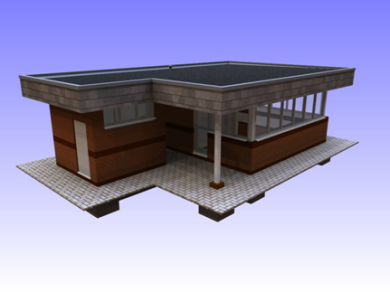

A model lit with normal lights

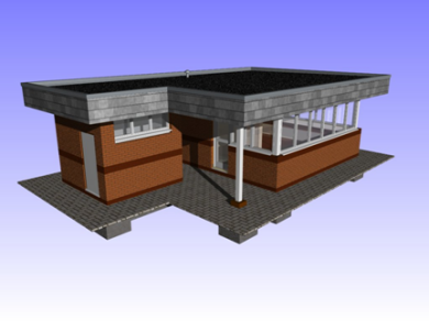

The same model lit with image-based lighting
You can see the difference this form of lighting can make to rendered images. And the enormous advantage here is that it is much easier to set up than traditional lighting.
