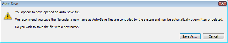

  5. When you are prompted to save a file with a different name, click Save As.
  6. In the Save As dialog box, enter a new file name, and browse to the desired location.
  7. Click Save.
