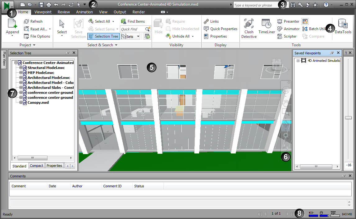

This section briefly describes the main components of the standard Autodesk Navisworks interface.
The Autodesk Navisworks interface is intuitive and easy to learn and use. You can adjust the application interface to match the way you work. For example, you can hide docking windows that you rarely use, so they do not clutter the interface. You can add and remove buttons from the ribbon and the Quick Access toolbar.
You can apply a different theme to the standard interface.
| 1. Application button and menu | 5. Scene View |
| 2. Quick Access toolbar | 6. Navigation bar |
| 3. InfoCenter | 7. Dockable windows |
| 4. Ribbon | 8. Status bar |
