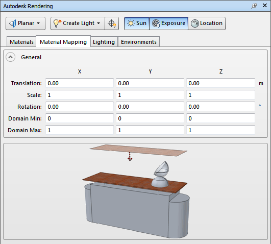

Planar Mapping
Texture coordinates are computed with a planar projection of 3D points.
The transformed X and Y coordinates are adjusted based on the Domain Min and Domain Max values, and used as U, V as follows:
U = (X - Xlow)/(Xhigh - Xlow)
V = (Y - Ylow)/(Yhigh - Ylow)

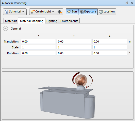

Spherical Mapping
The texture coordinates are computed by a spherical projection at origin.
Imagine you put a sphere around the object. Each X, Y, Z point is projected onto the nearest point on the sphere. U, V are, effectively, the polar coordinates (pair of angles) of the point.

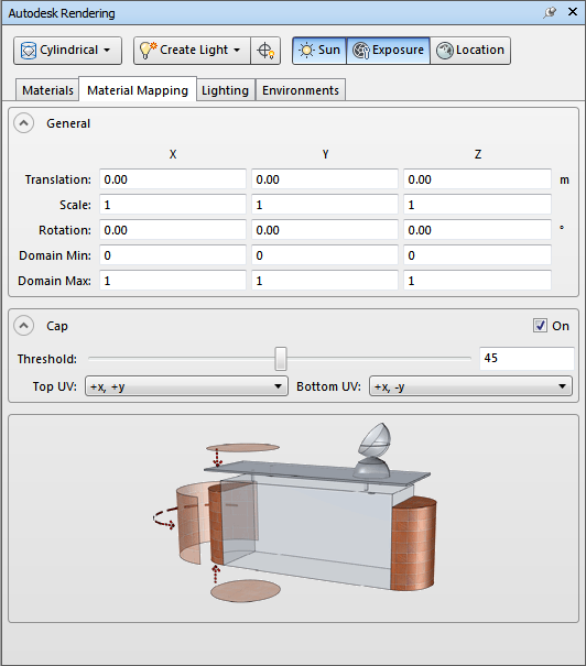

Cylindrical Mapping
Coordinates are mapped either to the cylindrical surface (sides) or the planar 'caps' at each end of the cylinder (if the Cap check box is On). If the Cap check box is not selected, just cylindrical surface is used.
Cylindrical mapping is similar to box mapping, except you need to imagine putting a cylinder around the object.
The Cap check box determines if the cylinder caps should be texture mapped with a different transformation than the cylinder side. Threshold is angle in degrees between point and cylinder axis used to decide whether a cap or side mapping should be used. By default, an equivalent of 45 degrees is used. Cap direction (Top UV and Bottom UV) specifies the orientation of the texture coordinates on the caps, similar to the direction parameter for box mapping.
If the Cap is used, you will get planar mapping, just like the box mapping sides.
If cylindrical surface is used, then U is based on angle, just like spherical U, and V = Z (after Domain Min and Domain Max mapping is applied).
