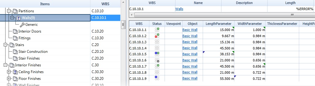

When an item or group is changed, a warning flag appears in the Navigation pane and a green or blue triangle appears in the cell. The overridden formula also appears in bold in the Item Catalog. Once Change Analysis is carried out, the following notifications appear in the Status column of the Quantification workbook.
Action How Indicated Icon When Shown
Override Green light in Status column When a formula has been overridden and Change Analysis has not been run. Hover the icon to see a tooltip.
Change Blue light in Status column Where a model object has changed and differs from the associated takeoff item in Quantification Workbook. Hover the icon to see a tooltip.
Error Red light in Status column Where there are computation errors with the formula or model item. Hover the icon to see a tooltip.
Delete Black light in Status column Where a takeoff's model item has been deleted. Hover the icon to see a tooltip.
Note: Any number of the above status notification lights may appear in the Status column for one takeoff item.
