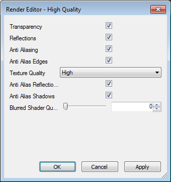

To edit your chosen rendering style, double-click the style in the palette. The Render Editor dialog box opens. Each editor will be different for each type of rendering style. The High Quality editor is shown here:
At any time, click Apply to apply the parameter edits to the scene.
