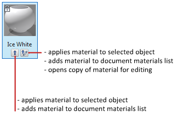

Apply a Material from the Materials Tab
To apply a material from the Materials tab
Select an object in the Scene View or in the Selection Tree.
Click
Render
tab
System
panel
Autodesk Rendering
Right-click a material and click
Assign to Selection
on the context menu. The material is applied to the object.
