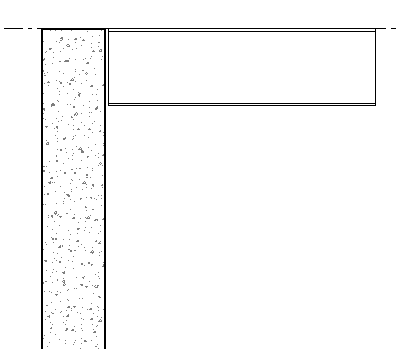

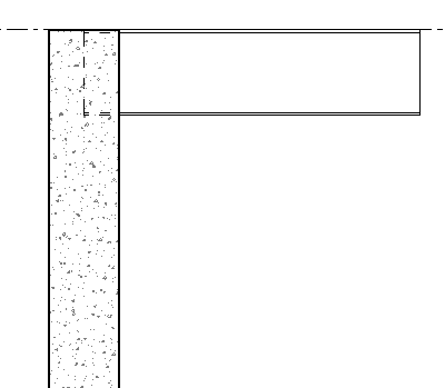

Setback and cutback apply when connecting beams to structural walls. The beams are independent of one another, are only associated with the common wall, and will cut back from the wall accordingly. Recessing the beam into a beam pocket is possible by removing the cutback with the Beam/Join tool.
Cutback Beam to Wall Join | Non-cutback Beam to Wall Join |
