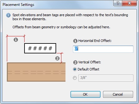

Click the Settings button to open the Placement Settings dialog and adjust the offset of tags and spot elevations from beams.
The Horizontal End Offset and Vertical Offset settings adjust the distance of tags and spot elevations from their attachment points (see Structural Framing Tag Families) by the entered measurement. This measurement is representative of the drawing scale and its default is 0" horizontally and 3/8” vertically.
