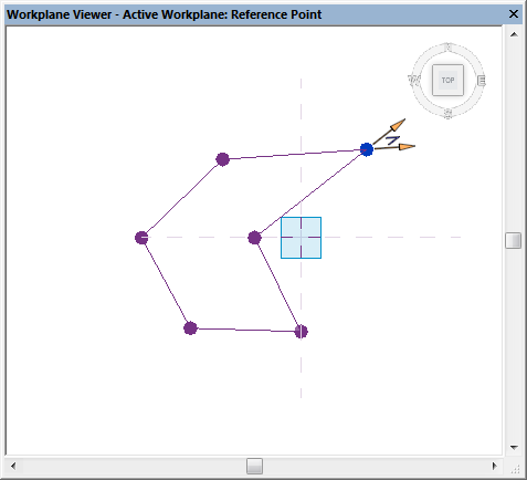

The sample images in the following procedure use this sweep as the starting point:
To edit with the Workplane Viewer
  1. Select a work plane or element profile.
  2. Select Modify | <Element> tabWork Plane panel Viewer.
    The Workplane Viewer opens to the appropriate 2D view.

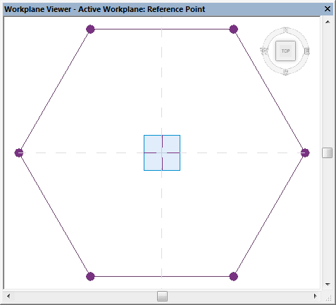

  3. Edit the model as needed.
When you make changes in a project view or in the Workplane Viewer, other views are updated in real time.
