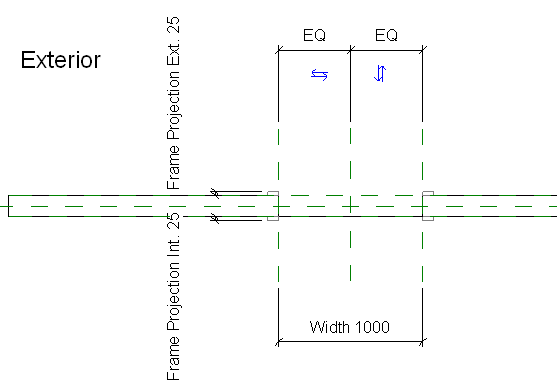

The new family opens in the Family Editor. For most families, 2 or more dashed green lines display. These are reference planes, or the working planes that you will use when you create the family geometry.
If you are creating a host-based family, host geometry may also display.
The family views vary depending on the type of family that you create. If necessary, you can create additional views by duplicating and renaming existing views.
