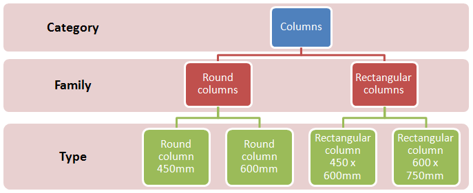

Element
When creating a project, you add parametric building elements to the design. Revit LT classifies elements by categories, families, and types.
Category
A category is a group of elements that you use to model or document a building design.
Examples
Family
Families are classes of elements in a category. A family groups elements with a common set of parameters (properties), identical use, and similar graphical representation. Different elements in a family may have different values for some or all properties, but the set of properties—their names and meaning—is the same.
Examples
Type
Each family can have several types. A type can be a specific size of a family, such as a 30” X 42” or A0 title block. A type can also be a style, such as default aligned or default angular style for dimensions.
Instance
Instances are the actual items (individual elements) that are placed in the project and have specific locations in the building (model instances) or on a drawing sheet (annotation instances).
