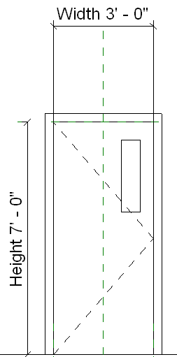

You have added a rectangular window to a fire door that has a labeled dimension for the width, but you have not dimensioned the window.

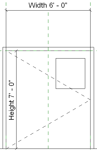

You decide to change the width of the door, but you want the window width to stay the same. You expect its position to remain unchanged; however, observe what happens when you increase the width of the door using the Family Types tool.
In this example, the window is constrained to the centerline of the door and the right side of the door panel, both of which are represented by reference planes. The window's position remains fixed relative to those reference planes.
To see the automatic sketch dimensions, edit the sketch of the window and turn on the visibility of the dimensions. You will see how the vertical sketch lines of the window are dimensioned to the center and right reference planes.
Image legend:
  1. Auto sketch dimension to right reference plane.
  2. Auto sketch dimension to center reference plane.
To achieve the desired results, add locked dimensions. For example, you could add a locked dimension for the width of the window and a locked dimension from the window to the right reference plane.
