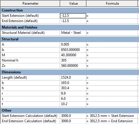

  4. Click Modify tabProperties panel (Family Types).
  5. In the Family Type dialog, verify the following parameters are present:
    • under Construction, Start Extension
    • under Construction, End Extension
    • under Other, Start Extension Calculation with a formula containing Start Extension
    • under Other, End Extension Calculation with a formula containing End Extension.
    If these conditions are not fulfilled, the family should not be updated.
  6. Select each of the four parameters listed in the previous step and click Remove. Once all four are removed, click OK to close the Family type dialog.

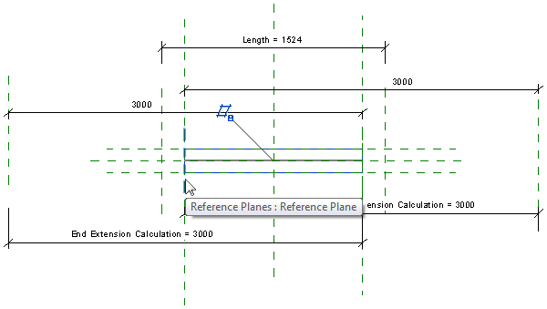

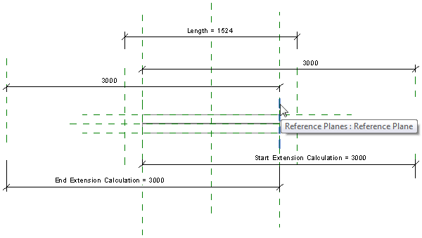

  7. In the Ref. Level view, select the unnamed reference plane immediately to the left of the sweep and press Delete. Note that another reference line is immediately below the deleted reference. Leave that in place.
  8. Repeat the process in step 7 to delete the reference line to the right of the sweep.

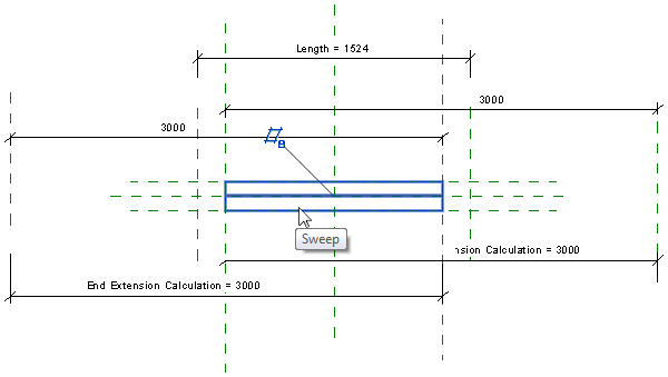

  9. Select the sweep.
  10. Click Modify | Sweep tabMode panel (Edit Sweep).
  11. Click Modify | Sweep tabSweep panel (Sketch Path).

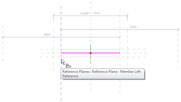

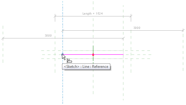

  12. Select the path.
  13. Click Modify | Sweep > Sketch Path tabModify panel (Align).
  14. Select the Member Left reference plane.
  15. Select the left side of the path.
  16. Lock this alignment.
  17. Repeat steps 14 - 16 using the Member Right reference plane and the right side of the path.

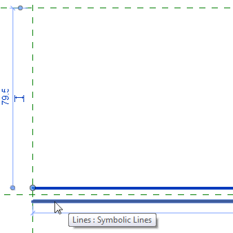

  22. On the View Control Bar, click (Temporary Hide/Isolate) Hide element. The Fine detail level sweep is now hidden; the two symbolic lines representing the web of the steel element is now exposed. You may need to zoom in to see them distinctly.
  23. Click Modify tabModify panel (Align).
  24. Repeat steps 14 - 17 to adjust the constraints for both symbolic lines.

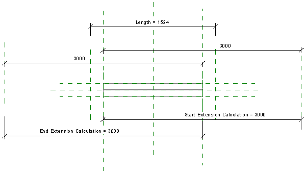

  26. Select the unnamed reference plane to the far left and press Delete.
  27. Select the unnamed reference plane to the far right and press Delete. The family is now updated.
  28. Save the family.
    When reloaded into a project, the family will no longer possess the Start and End Extension parameters, Start and End Extension Calculation parameters, or shape handles for editing extensions.
