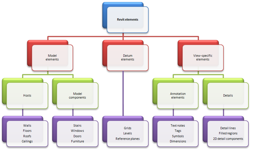

In projects, Revit LT uses 3 types of elements:
Examples:
There are 2 types of model elements:
Hosts (or host elements) are generally built in place at the construction site.
Examples:
Model components are all the other types of elements in the building model.
Examples:
There are 2 types of view-specific elements:
