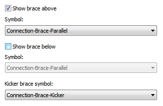

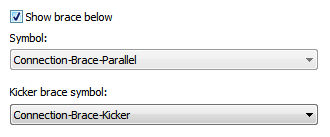

Plan representation options:
Show brace above
Show brace below
Kicker brace symbol

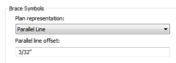

Plan Representation options
Symbolic representation of braces in a plan view are displayed with a line parallel to and offset from the brace at the value specified in the Structural Settings dialog. The line displays below, or to the right to vertical brace centerline if the brace is below the level and above, or to the left to vertical brace centerline if the brace is above the level.
Symbolic representation of braces in a plan view are displayed with an angled line. Line with angle originates from the point of intersection of a brace and level if they intersect, and from the closest point to the level on the brace otherwise. The symbol goes upward (downward) for the portion of the brace which is above (below) the level.
This value is available only after selecting Parallel Line for Plan representation. The parallel line is offset the specified value from the vertical brace centerline.
