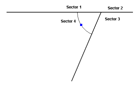

- Drag the cursor to size the angular dimension. Select the sector where you want the dimension to display:
Wall join with 4 distinct sectors
- When the dimension is sized properly, click to place it.
