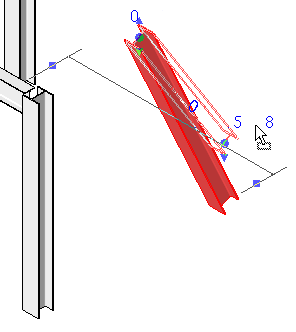

- Adjust the position of the top of the column with the column endpoint control. If the column is set to Slanted - End Point Driven, you adjust the elevation of the top of the column using the vertical arrow or text controls.
Angle-Driven Modification
- Adjust the position of the base of the column with the column endpoint. If the column is set to Slanted - End Point Driven, you adjust the elevation of the base of the column using the vertical arrow or text controls.
Endpoint-Driven Editing
The column adjusts its length and slant based on your parameter settings and endpoint adjustments.
