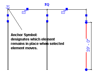

    Example
    The following image shows the equality dimension, with the selected element in red, and an anchor symbol near the dimension.
  4. Click and hold the anchor symbol. A witness line appears for the anchor.
  5. Drag the anchor symbol to the element you want to anchor.
  6. Move any of the unanchored elements referenced in the dimension.
    The element accompanied by the anchor does not move.
