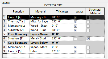

The structure of vertically compound walls is defined using either layers or regions. The following image shows the Edit Assembly dialog.
Just as roofs, floors, and ceilings in Revit LT can consist of multiple horizontal layers, walls can consist of more than one vertical layer or region. The position, thickness, and material for each layer and region are defined in the Edit Assembly dialog, which is accessed through the type properties of the wall. You can add, delete, or modify individual layers and regions, or add sweeps and reveals to customize the wall type.

Layer rows: correspond to wall layers or regions
A layer is assigned to one row. It has a constant thickness and extends the height of the wall. You can change its thickness in the row assigned to it.

Wall layer: constant thickness and extends the height of the wall
