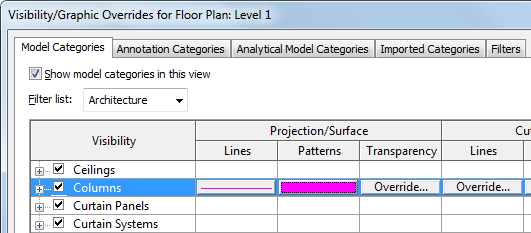

Example
In the following image, the Columns category has overrides for projection/surface lines.
