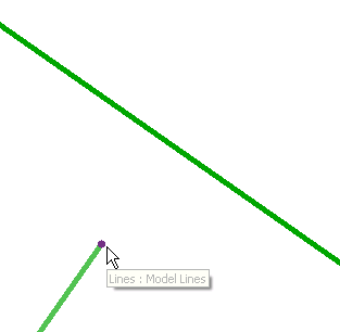

- Join selected endpoints (of walls, for example) with a selected line.

Selected point to align to an element
Element and point joined
