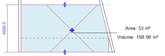

For example, the following drawing shows a section of a room with a sloped wall. The dotted line across the lower part of the room indicates the current computation height. (This line displays when you select the room.) Revit LT uses the perimeter of the room at the computation height when computing the room area and volume.

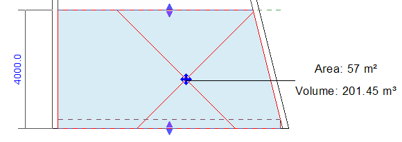

Changing the computation height affects the room perimeter, and thus the room area and volume. For example, the following drawing shows the same room, but the computation height has been moved lower (indicated by the dashed line). The room tag shows the changed room area and volume.
