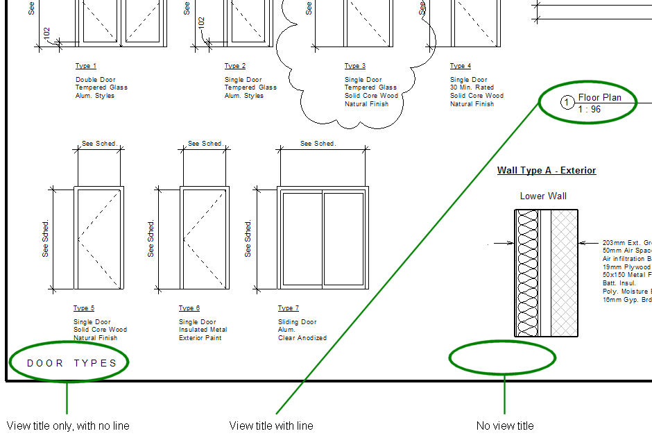

When you place a view on a sheet, by default Revit LT displays a view title. You can specify text attributes for view titles, define the information to include in a view title, or omit view titles from sheets. You can define these attributes for individual view titles on sheets. You can also define view title types and use them to apply standard settings to view titles.
To change the weight, color, or pattern of the horizontal line in a view title, or omit the line from the view title, create or modify a viewport type. See Viewport Types. To change the length of the horizontal line for an individual view title, see Modifying a View Title on a Sheet.
Note: View titles display only for views, such as floor plans, elevations, sections, and 3D views. View titles do not display for schedules.
Examples of view title styles
