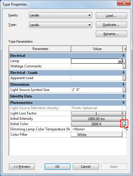

- Link the Initial Intensity parameter of the candle family to the Initial Intensity parameter of the host chandelier family.
When you link these parameters and add a chandelier to a building model, in the project you can adjust the Initial Intensity parameter (or other linked parameters) for the chandelier as a whole. You cannot change the Initial Intensity of individual candles in a chandelier.
How?
- In the host chandelier family, select one of the candles from the candle family.
- Click Modify | <Elements> tab
Properties panel
(Type Properties). The Type Properties dialog displays a column with an equal sign in the column heading
. A gray button displays in this column for each type parameter that you can link to other parameters.
- Click the gray button in the
column for the Initial Intensity parameter (or any other parameter that you want to be able to change for the chandelier in a project).
- In the Associate Family Parameter dialog, select Initial Intensity (or the parameter that corresponds to the type parameter that you selected), and click OK.
