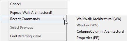

While working in Revit LT, you can repeat the command that was last used, or select from a list of recently used commands.
To repeat commands, do any of the following
- Right-click in the drawing, and click Repeat [Last Command].
- Right-click in the drawing, and click Recent Commands
<Command Name>. Recently used commands are options as shown here. A maximum of five recent commands display in the list.
Note: The following are not available from the recent commands list: tool settings, in-canvas and view commands, modify, redo/undo, copy/cut/paste, finish/cancel, and some Options Bar commands
- Press Enter to invoke the last-used command.
- Assign a keyboard shortcut for Repeat Last Command.
