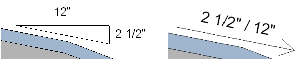

A spot slope displays the slope at a specific point on a face or an edge of a model element. You can place spot slopes in plan views, elevation views, and section views. The following illustration show the 2 spot slope types.
Objects using spot slopes most commonly include roofs, beams, and piping.
