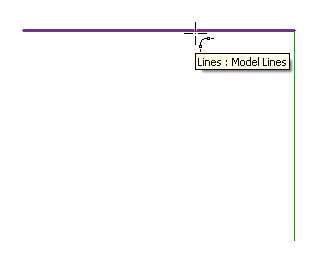

  3. Select the first element to fillet.

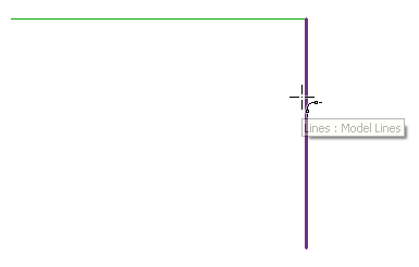

  4. Select the second element to fillet.
