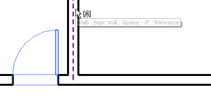

Example
Selecting the element to mirror (and copy) and the mirror axis
Mirrored (and copied) door
