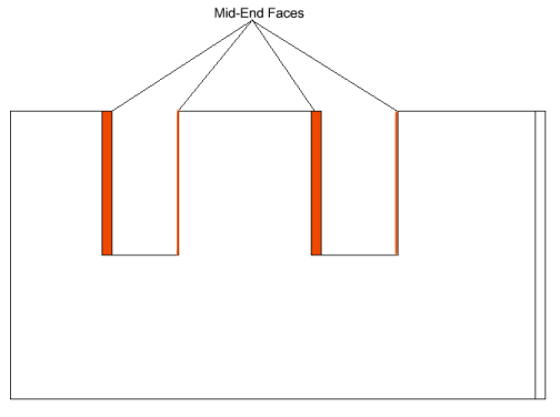

Creating Mid-End Faces
When you edit the elevation profile of a wall that spans multiple levels and create notches such as those shown below, the new vertical edges represent jambs that are referred to in Revit as mid-end faces. Other walls can form corner joins with mid-end faces. See Joining Walls to Mid-End Faces.
Wall elevation profile edited to create notches
Edited wall in 3D view
