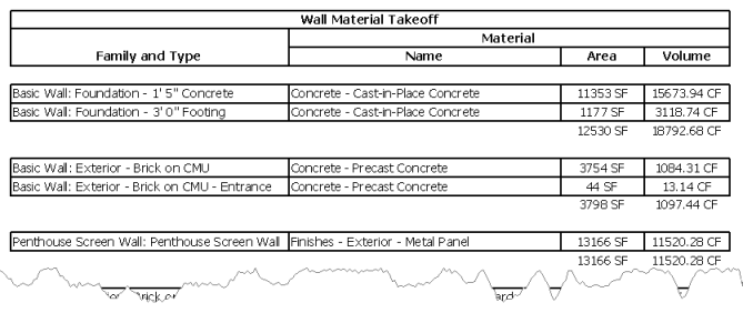

Material Takeoff Schedules
Material takeoff schedules list the sub-components or materials of any Revit LT family. Material takeoff schedules have all the functionality and characteristics of other schedule views, but they allow you to show more detail about the assembly of a component. Any material that is placed in a component within Revit LT can be scheduled.
Note: When Revit LT computes the volume of materials for individual layers within a wall, some approximations are made to maintain performance. Minor discrepancies might appear between the volumes visible in the model and those shown in the material takeoff schedule. These discrepancies tend to occur when you add a sweep or a reveal to a wall, or under certain join conditions.
