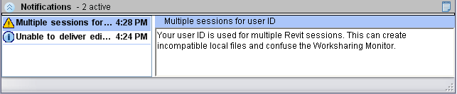

An active notification informs you of a current issue that impacts (or may impact) your work in Revit. The Worksharing Monitor lists these messages in the Notifications pane. It may also display desktop alerts about these issues. (See Setting Options.)
To see the details of a notification, click its summary in the left list. The notification description appears on the right side of the pane.
Autodesk Revit Worksharing Monitor displays 2 types of notifications.
Icon | Type | Description |
Warning | The situation may cause worksharing or Autodesk Revit Worksharing Monitor to stop working. Take action to resolve the issue. |
Notice | The situation may hinder your Revit activities. |
When an issue has been resolved, its notification moves to the Notification history.
