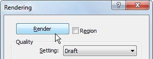

After preparing the 3D view and using the Rendering dialog to select desired settings, click Render to render the image.
Revit begins the rendering process, rendering one block of the image at a time. Revit displays a progress dialog, which shows information about the rendering process, including the numbers of daylight portals and artificial lights.
