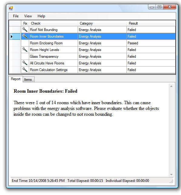

The information contained in the Check Results Browser has each check and result (Pass, Fail or Report Only) listed at the top for a quick overview. Detailed information about which specific items passed/failed against the given criteria is provided at the bottom of the browser window on the Report and Items tabs.
The Check Results Browser is shown below:
The Report tab provides details on the results of the check. When the check fails to meet the desired criteria a table of affected geometry or data will be shown and a detailed message is provided for the user.
The Items tab provides more specific information about the check results. It lets you select an item from the list, and then use Revit to find the best view for adjusting/editing where the source of the issue exists for review or manual correction.
Next to certain checks a "wrench" icon may be displayed in the Fix column. This indicates you can use Model Review to automate correction (where applicable). Details on each check template and options can be found in the Check Types Explained section.
