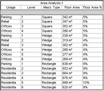

  5. In the schedule, assign a usage to each mass floor.
    Enter text in the Usage column for each level. After entering initial values, for the remaining rows you can click in the field to select values from a list.

  10. Click OK.
The schedule updates to sort and subtotal the rows accordingly. It shows the percentage of floor area planned for each usage, as well as square units.
