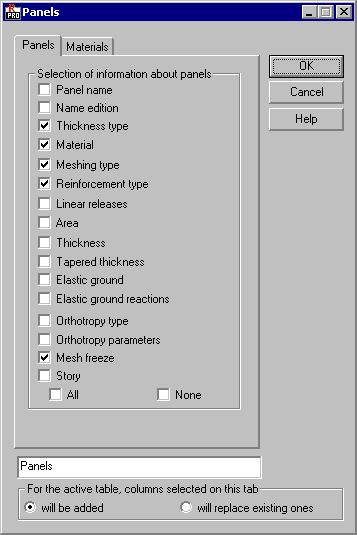

Selecting the Panels tab in the Columns dialog to select panel quantities for presentation.
The following quantities may be selected.
- Panel name.
- Thickness type.
- Material.
- Panel thickness or panel thicknesses (for panels with variable thickness).
- Elastic ground coefficient.
- Meshing type (Delaunay's method, Coons' method).
- Panel reinforcement type.
- Linear releases.
- Panel area.
- Panel thickness (constant or variable).
- Elastic ground.
- Elastic ground reactions - A value of the Kz reaction is a sum (an integral) of the elastic ground reaction for a panel on the elastic ground. The value is constant for a whole panel.
- Type and parameters of orthotropy.
- Parameter informing if the finite element mesh is frozen for panels.
- Story of the panel.
