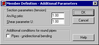

The option defines additional code parameters for the steel member type. Click the More button in the Member Definition - parameters dialog. The following dialog appears:
The additional member parameters include:
This value applies to a tensile force acting on the cable. It is a coefficient that defines the relationship of the member cross-section area, not considering the bolt or rivet openings (Anet), to the total cross-section area (Agross).
