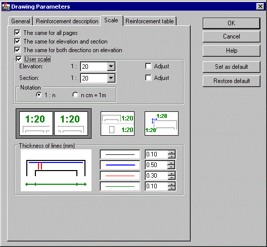

Select Analysis > Drawing or click (Drawing parameters) and then select the Scale tab.
The Scale dialog options are described as follows.
Same for all pages. The scale for the drawing of one element is imposed on all pages. For example, in the case of a beam comprising several spans each is presented on a separate page, identical scaling for all pages that contain an instance of the selected beam.
Same for elevation and section. An element section and its view are drawn in an identical scale
Same for both directions on elevation. Maintains the aspect ratio of the element when scaled.
User scale. You can set your own scale of views and sections before their generation. The following options become accessible when enabled.
Note: Some scale settings accompanied by manual element scaling produce unexpected scale modification of of the remaining elements of the drawing.
Line thickness may also be selected for:
These settings allow fitting a final drawing to your needs and printer capabilities.
