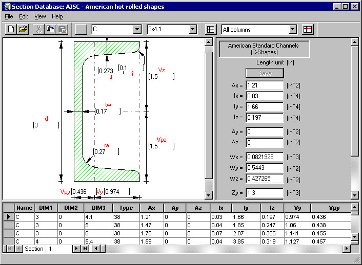

In Robot, all data pertaining to section geometry is stored in the standard bar section databases. You use them by providing the name of the appropriate database. You can also define your own section database to store the frequently used sections.
Select Tools > Section Database from the Robot menu or click - to open the Section Database viewer. The viewer displays information about standard sections and provides tools to perform operations in section databases.
The Section Database is divided into several parts.
In the toolbar are a selection field and 2 icons: . This field allows you to select a set of columns to present in the table. Basic columns and All columns are the default sets.
You can define your own set with the Visualization of columns option.
Press the Adjust column width icon to automatically adjust the width of the columns in the section data table.
The individual parts of the viewer, dialog, and table may be adjusted to your needs. The table may be separated vertically as well as horizontally using splitters. A vertical splitter is activated in the lower left corner of the table (). Vertical table division is synchronized in which records of the same line may be viewed. A horizontal splitter is activated in the lower right table (). Horizontal division allows for undocked viewing and comparative examination of lines in the database.
