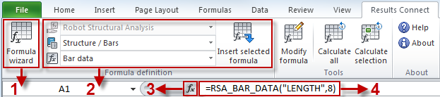

You can define formulas, that allow acquiring information from Autodesk Robot Structural Analysis Professional project, using either of the following ways.
You can access it from the Ribbon by clicking Results Content tab
Formula definition panel
Formula wizard.
You can specify the following settings by using selection drop-down list available on the Ribbon:
Insert selected formula.
You can access it from:
Function library panel
Insert Function
Insert Function icon.
You can find all necessary information about each formula in the Formula list.
You can modify formulas after inserting them in the worksheet.
Tools panel
Modify formula.
You can calculate formulas after modifying the project in Autodesk Robot Structural Analysis Professional.
The following types of calculations are available:
Tools panel
Calculate all.
Tools panel
Calculate selection.
