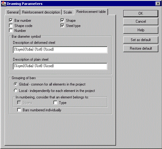

Select Analysis > Drawing or click (Drawing parameters) and then select the Reinforcement table tab.
Options in the Reinforcement table dialog let you parametrize the display of the summary reinforcement table. You can add or delete any table column. In descriptions of deformed and plain steel, it is possible to set the reinforcing bar diameter symbol. You can use variables available in Robot:
Grouping of bars
While grouping, the following bar properties are used: steel type, diameter, geometry and shape code. If all these properties are identical for several bars, they can belong to one group.
Select the Global - common for all elements in the project option to group and assign names (numbers in labels) within all RC elements in a Robot file (*.rtd file).
After selecting Local - independently for each element in the project each element keeps its individual number. Here are also the options used to specify additional properties considered while grouping elements (you can select the Spans option only for Local numbering). 2 of these options are In numbering, consider that an element belongs to: Spans or Type. Spansrefers only to beams and does not let you group bars from different spans. That bars belong to a type means that although invariable properties of 2 bars are identical, they will not be put into one group when they belong to different reinforcement types; examples of a reinforcement type: top or bottom reinforcement, main or constructional or assembly reinforcement, reinforcement in the direction X or Y.
If you select Bars numbered individually, then each bar has a separate number.
