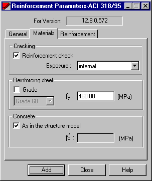

Select the American code for plate and shell reinforcement from the Job Preferences/Codes dialog. Click the Material tab in the New Reinforcement Parameters dialog to select basic material parameter for designed RC structure elements.
Cracking field (Reinforcement check and exposure).
Reinforcing steel field (steel grade or elasticity limit).
