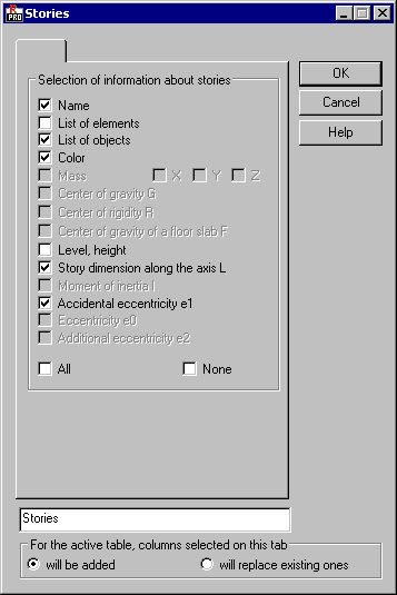

The Stories tab displays the geometrical properties of each story: list of objects and elements of a story, color, level and heigth, story dimensions Lx, Ly, and the values of accidental eccentricities ex1 and ey1.
On the Values tab, physical properties of each story are displayed: coordinates of the center of gravity and the center of rigidity, mass moments of inertia, as well as eccentricities e1 and additional eccentricities e2. A column containing the coordinates of the story slab center of gravity can also be added. Notice that the values of the masses are given for each case, because each case can have different added masses acting in selected directions X, Y, Z. The Masses column indicates the maximum mass of the story acting in these directions. Columns describing the values of the story mass operating in every X, Y and Z direction may also be added.

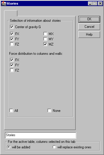

The Reduced forces tab displays forces in a section through a story (a cut through panels and members) reduced to the center of gravity.
Results are displayed by load cases and successive stories (first column). The next columns show the following information:
Reduced forces for a story are calculated based on external loads applied to nodes of the story. If loads are applied to objects such as columns or walls, Robot considers forces distributed to nodes of a member or to nodes of a finite element mesh of a panel. As a result, loads applied to nodes at the lower level of the story are ignored in the sum of forces for a story.
Nodal loads are reduced to the center of gravity of a story. Thus, forces and equivalent moments in the 3 directions: X, Y and Z are obtained.
Reduced forces per columns on a story are calculated based on internal forces in the member cross-section. The cut is parallel to the XY plane of the global coordinate system at the level of the center of gravity of a story. As a result of the reduction, a set of 3 forces and 3 moments reduced to the center of gravity is obtained.
Reduced forces per walls on a story are calculated as a difference between the total reduced force for a story and the reduced force for columns.
